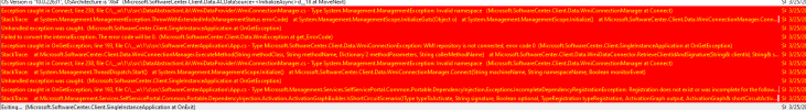

Just did an site upgrade to 2309 yesterday and all went well. I piloted the pre-production client to a pilot collection that my device is a member of. I'm having an issue where the Config mgr client is not able to communicate to the Primary Site (does not open in control panel) and software center is not loading (Error: software center cannot be loaded). Any new device deployments using the existing Task sequence are successful but its installing the new client which is not able to communicate to the MP. I have not attempted to rebuild the WMI as there can be a huge risk with data being wiped. Any suggestions to check after the upgrade? Ive attempted to do a CCMrepair and was unsuccessful. tried uninstalling the client and get the same issue. All existing devices are working fine and are able to connect to the MP and SC is loading as normal. Kinda stuck here. Checked the [email protected] and CCMExec.log and found some errors. Tried doing some research and not able to find a real solution. Any guidance is appreciated.
2024-03-25 11_29_53-PENDING - Software Center Connection issues after site upgrade to 2309 _ S...png13.8 KB · Views: 5
2024-03-25 11_29_06-Configuration Manager Trace Log Tool - [[email protected]49.8 KB · Views: 5
