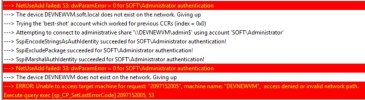

I tried to install SCCM Client, but it is failed, I can access to the client pc with \\E-SQL\$admin and the firewall on both client and site machine is turned off and the account have been added to admin group on both Site and Client Machine.
Here are the logs on both client(ccmsetup) and server(ccm), the problem is not only on this machine.

Hello eliowehbe,
When the ccmsetup.exe process is launched on the client machine, it means that the client push was successful.
After a quick log analysis, saw that you are using HTTPS communication, does your E-SQL client machine has the required certificate? Have you tried client manual installation?
CCMSetup.exe /mp:E-SCOM.soft.local SMSSITECODE=HQ1 /UsePKICert
Make sure also that your boundaries and boundary groups are set correctly.

Seems like DNS issue to me. Use the nslookup to see if you can resolve host.
