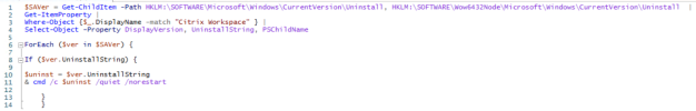

I managed to find a Powershell script which, when copied to a machine and ran from Powershell, seems to work fine but I can't get it to work when running from MECM;
I tried creating a Task Sequence and adding a line to run a Powershell script. I then edited the script, pasted in the above and selected to Bypass the execution policy but, when the Task Sequence is deployed, it says it is running but doesn't seem to do anything, having left it for 30 minutes.
