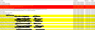

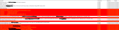

I'm setting up Configuration Manager and my management point is in a critical status. Some help with these errors would be appreciated. Attaching ccmsetup.log and mpcontrol.log.

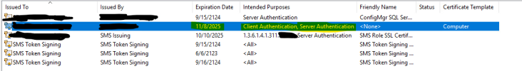

The server was previously using a self signed cert, but a domain CA cert was issued yesterday. Attached is what I see in IIS. The first row, the cert is issued by the server. The second row, the cert is issued by the domain CA.
Use the second one and make sure it is dual purpose CA issued cert. Restart server or IIS and let us know.

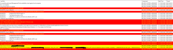

Apologies for the delay. I was waiting on somebody to request a dual purpose certificate for the server. It looks like a lot of red went away in the mpcontrol.log, but still getting the "Call to HttpSendRequestSync failed for port 80 with 12044 error code." error. Management Point is still in critical status. Any ideas of what could be causing this? Attached mpcontrol.log.

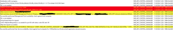

It's worth noting that this machine is STIG'd. I changed the site communication settings to HTTPS only. Now I'm getting a "Call to HttpSendRequestSync failed for port 443 with 12030 error code" error in mpcontrol.log. This seems to be a certificate based error as well. Where all do I need to put a certificate? I see that the distribution point is using a self-signed cert, but do I need to import one instead?
In that case make sure IIS binding is correct for the default web site for port 443 with CA issued cert that has dual purpose.

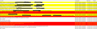

The correct cert is binded in IIS. Attached is the https binding for IIS. Also attached mpcontrol.log now that I switched site communication to HTTPS only.
