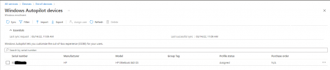

That script for importing the Hardware info looks great. I just can't get it to run and not sure where to look for errors. I haven't tried in a TS yet as I wanted to test on an existing machine first (that is not in Autopilot). Unfortunately as per my screenshot it doesn't seem to import:
All sorted now, user error :/
