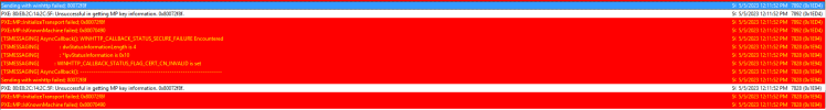

I boot the device using PXE and I'm getting a few issues mainly to do with the certificate, i have followed the steps to renew the certificate, removed the managment point and so on but this has not changed the issue I'm getting.
On the device i get searching for DHCP, then it connects and assigns an IP to the device, the i get TFTP.
PXE-T00: Failed to open file
PXE-E36: Error recieved from TFTP server
PXE-M0F: Exiting PXE ROM

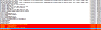

In SMSPXE.log on CMTrace i get
This has not solved the issue, i can see from the certificates in the third picture two of them have expired and i cannot renew them, could these be the issue?

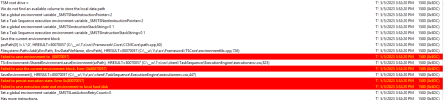

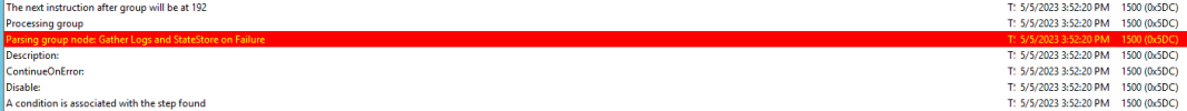

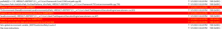

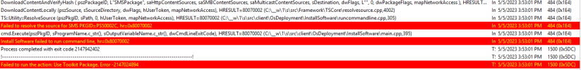

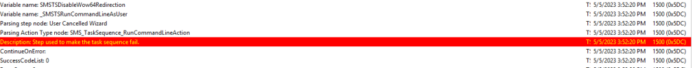

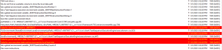

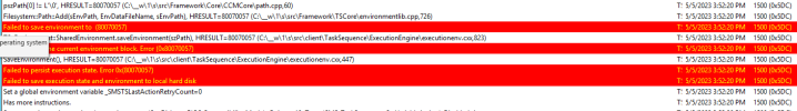

Ok, so PXE connected, it started the process, it only showed one task sequence but there are a few on the list, i selected the one it showed and it starts and runs for about a minute or two then fails.
so PXE boot - run WIM - Endpoint select task (Only Win 10 install showing) - install process Use Toolkit Package - Error Code 0x80070002
any ideas?
this is a system that was working, i inherited it from previous IT manager, the task sequences used to work.

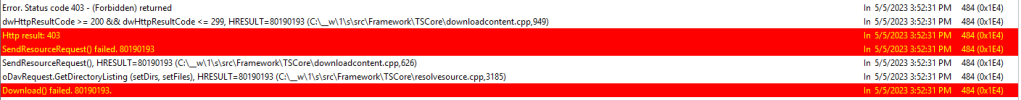

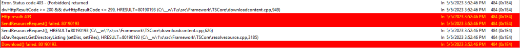

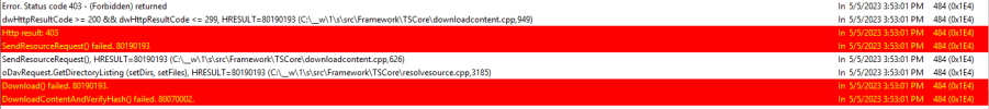

I'm checking IIS manager and http port 80 works in the browser but https:// port 443 has a certificate error the security certificate presented by this website was issued for a different website address.
its set to the server address should it be https://localhost/ ?
close this issue its now working on HTTPS it was a certificate that hadn't renewed properly, after deleting the new one and recreating it, its now working.
