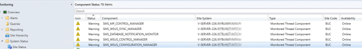

Since last week i have a serious problem with my SCCM 2006 (picture below), i also had a critical error in a Site Status Component "Software update Point"
After the 8th of may i had problems after installing KB5012596 (i think it started then). I detected the error yesterday and tried to figure out what may be the problem.
I uninstalled this update (picture below) and hoped that this will solve my problems but that did not solve my problems.
Software Update Point Error 1 the 8th of may directly after reboot for update installation

Now after 2 hours of running time i have no errors or warnings in the site status components but i have a warning in the component status overview in the "SMS_MP_CONTROL_MANAGER.

When i open the WSUS console i see this and it looks fine for me
