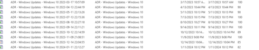

I wanted to attach a screenshot of the SUG created by ADR's. As you can see there is not one for Feb 2024.

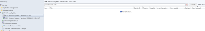

I did try this before. However I did recreate another ADR following your steps in the link you sent me. I forced a run on that ADR Called ADR - Windows Updates - Windows 10 (Test).
I waited a little and then i checked the ruleengine.log and have the same outcome. Please see screenshot:
I then opened the deployment package called ADR - Windows Updates - Windows 10 (Test) and show member however there are no members\updates in there. Please see attached.

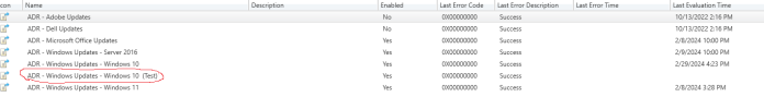

Here is my ADR that i created just for clarification.
