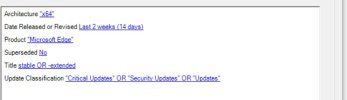

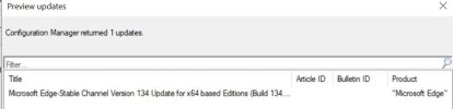

I recently created an ADR Rule to install ONLY Edge-Stable browser updates.
And yet, the ADR Rule installs both the Edge-stable and Edge Extended stable for the same version.
With the ADR I created if I run a software evaluation it only shows the EDGE STABLE product.
So I am not sure why it installs both since they have unique update ID's and I only requested Edge Stable.
My ADR filters are:
Architecture: 64x
Superseded: No
Title: Stable OR -extended
Product: Microsoft Edge
Date released: 2 weeks
Update: Classification-"Critical", "Security" or "Updates."
Thoughts?

My ADR filters are:
Architecture: 64x
Superseded: No
Thoughts?
I need to test this in my lab, but does the Title contain Stable OR -extended when you want to deploy only stable updates?
Title: Stable or -Extended...when I add both conditions...I only get "Edge Stable". If I remove "-Extended" then I get both Edge Stable and Edge Extended. The Title Filter says that by adding a "-Extended" it will remove the Edge Extended version. Unless I am filtering it incorrectly in the Title filter ...it shows only the Edge Stable Version. And it packages only the latest Edge Stable version. I even looked at the WHUA.log on several machines and only the Edge Stable version gets packaged and installed. So that's why I am confused why the ADR installs the Edge Extended Stable version as well or there's some other policy that's installing the Extended Edge Stable version and ADR is not too blame?
