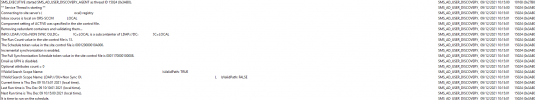

I'm trying to exclude MAC users from AD and display only valid users in SCCM so I have followed the steps as mentioned in your forum. Please refer to the attached screenshots.
After running "Full Discovery now", I still see MAC users in "Users". Could you please check and confirm whether I have configured correctly?
Please find the screenshot from adusrdis.log ,
Exactly which discovery method is locating the users? aka have you looked at the account in cm console to see. (properties)
