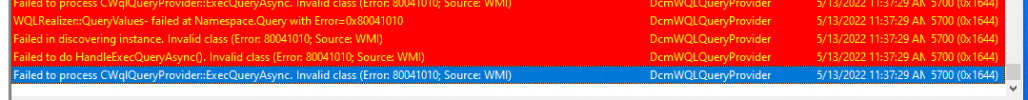

It works. However, when UWF is NOT installed DCMWmiProvider.log shows:
and the application fails install even though there is another deployment type that should run when UWF is not present. The deployment type that has highest priority looks for a registry key that is only present when UWF is installed and should run if it doesn't exist. I confirmed that by deleting the second deployment type that queries WMI for the UWF_Filter class. The application immediately installed.
If UWF is installed, the above UWF_Filter query works and the application installs without error when UWF CurrentEnabled is false. It is only when UWF is not installed that the whole thing fails. I have tried adding the reqistry key exists requirement to the UWF Active deployment type without success and I tried adding a requirement that the CurrentEnabled property exists, but both attempts failed. We get the same invalid class error in the DCMWmiProvider.log.

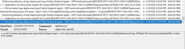

And it does not work. AppDiscovery.log shows:
And I don't know where to go from here...
Does anyone know the trick to getting a script to return a value to CM? I've tried the echo command (as indicated in the dialogs within CM), but I am not sure how to troubleshoot and see if the returned value is actually received by CM. I have tried returning a string (disabled or enabled) and an integer (0 or 1), but neither seems to work. --I'm not even sure the script runs on the target. I have tried self-signing the script and importing that certificate to the target machine and also tried eliminating the signature and setting the execution policy to "unrestricted", but I seem to be flailing...
