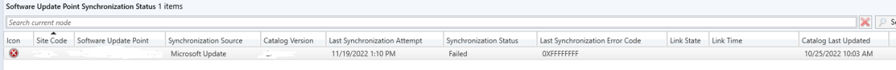

Anyone who can explain to me the issue here please. My last syn was October 225, 2022. It shows it has failed.
See the error from the logs below.
WCM.log error
Do you use proxy server in your setup?. When was the last time the sync had worked and if it had worked, then check what changes were made. You must involve your network admin here.

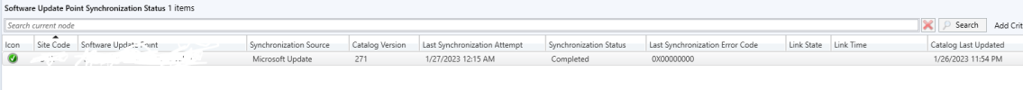

Yes, we use proxy. I had dived into it and found out that the WSUS was configured in the primary site. It was initially configured in distribution point server, and it had stopped. I stopped on the primary site and restarted in the DP. Everything works now.
