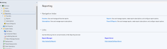

Last week we migrated the CM Database to new supported SQL Server, today we moved the reporting service to a separate server that has SSPR running on it.
All the ConfigMgr_xxx reports are accessible via the web service link and run.
Within the console shows the Links to the correct SQL Reporting Services.
When going to Reporting > Reports in the Console they are empty.
Under Report Options I can select the Report Services Point but then get the following error.
have checked the srsp.log and can not see any errors.

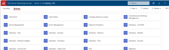

What about the local firewall on the ssrs server? On a remote computer can you access the ssrs website for both urls? Admin and website.
there are no firewalls
can access both SSRS url per the screen shot attached - is only the console that that can't and have tired it from the site server, local installed copy of the console on other devices all have the same issue.
