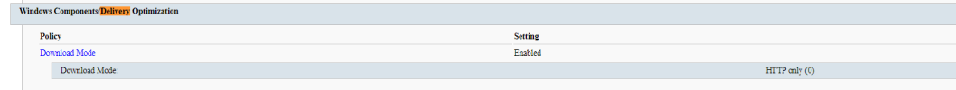

Could you please what would be the setting for delivery optimization. As we have a gpo to se it to below. We are expecting that it might have some impact on Windows 11 Devices.
