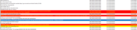

searching for QFE packages in C:\Program Files\Microsoft Configuration Manager\EasySetupPayload\offline
Failed to obtain easy setup payload. Retry in the next polling cycle in the log file.

so it's stuck at downloading.. Could you navigate to \Monitoring\Overview\Updates and Servicing Status. right click the update and click check status. Attach the screenshot.

WARNING: Failed to download easy setup payload with exception: Could not find a part of the path 'G:\Program Files\Microsoft Configuration Manager\EasySetupPayload\ConfigMgr.Update.Manifest.cab'.
WARNING: Retry in the next polling cycle

I have never the warning "Failed to download easy setup payload with exception: Could not find a part of the path" before. What I can guess is the ConfigMgr.Update.Manifest.cab is not present and ConfigMgr is looking for that particular file. I can also see that the cab file isn't downloading on the server.
Can you open the browser on ConfigMgr server and try manually downloading the ConfigMgr.Update.Manifest.cab from that redirect URL (see the log file). Let me if you can download the .cab file.
