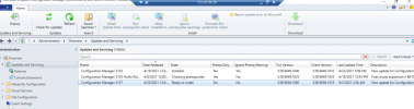

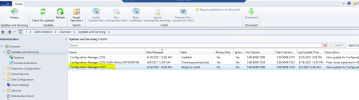

Hy everyone
I recently did a prerequisite check for configuration manager 2013 hotfix Rollup kb10036164. the prerequisite is ok. However, the installation was not followed by the install update pack. since this observation version 2107 has arrived in ready to install.
the system is blocked because grayed out and I cannot validate the last version because 2103 is suspended for installation.
How to purge the update system proprerly
Thank you for your feedback

HI Prajwal,
1 I deleted first package because pb not resolved and reset primary package configuration manager 2013 hotfix rollup (kb10036164.)
2 By refresh update in console manager After few minutes the two last version was ready to do prerequsite check .
3 I run the prerequiste check for last version and prefered this option .
in progress now succesfully !!!!
