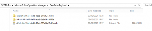

was wondering if anybody else is experiencing issues downloading v2107 in config manager?
in updates and servicing the downloading for v2107 gets stuck in downloading state and doesnt finish so i cannot do a prerequisite check.
dmpdownloader.log file shows
ERROR: Failed to download redist for 42e1cf6e-95a1-4a8d-96ad-311e6247b3fb with command /RedistUrl https://go.microsoft.com/fwlink/?LinkID=2167076 /LnManifestUrl https://go.microsoft.com/fwlink/?LinkID=2167071 /RedistVersion 202107 /NoUI "E:\Microsoft Configuration Manager\EasySetupPayload\42e1cf6e-95a1-4a8d-96ad-311e6247b3fb\redist" .
Failed to download redist for 42e1cf6e-95a1-4a8d-96ad-311e6247b3fb.
the EasySetupPayload folder has the cab file and it looks like it downloads it without any issues.
the logs show that its extracting the cab file.
ive tried using CMupdatereset but that hasnt worked.

Hi, sorry for late response. Just wanted to check if you were successful in downloading the 2107 update.
hey mate
unfortunately no...
every time i restart the sms_executive service or i run the cmupdatereset command it ends up at the same place saying error downloading ...
i can confirm that if i access the urls mentioned the files download instantly.
there are no proxies or FW rules blocking outbound internet connection to microsoft from our sccm server.
the 2103 hotfix downloaded instantly without any issues. (has not been installed yet)
also the 2103 version was installed via the console without any issues.
do you have any thoughts as to what might be happening?
