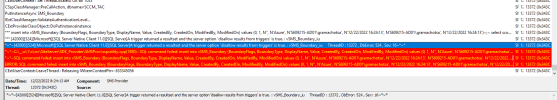

I'm trying to add a new boundary on my SCCM however I'm getting the following message error does anybody know why ?
My SCCM is 2107.

This is what i got from SMSPROV.LOG, I agree there is something weird with the database I don't know what; I already rebooted the database too.
PutInstanceAsync SMS_Boundary SMS Provider 12/22/2022 8:24:13 AM 13372 (0x343C)
IExtClassManager::ValidateAuthenticationLevel... SMS Provider 12/22/2022 8:24:13 AM 13372 (0x343C)
CExtProviderClassObject::DoPutInstanceInstance SMS Provider 12/22/2022 8:24:13 AM 13372 (0x343C)
*** insert into vSMS_Boundary (BoundaryFlags, BoundaryType, DisplayName, Value, CreatedBy, CreatedOn, ModifiedBy, ModifiedOn) values (0, 1, N'', N'Azure', N'S609215-AD01\gramachotsa', N'12/22/2022 16:24:13', N'S609215-AD01\gramachotsa', N'12/22/2022 16:24:13')~;~ select scope_identity() SMS Provider 12/22/2022 8:24:13 AM 13372 (0x343C)
*** [42000][524][Microsoft][SQL Server Native Client 11.0][SQL Server]A trigger returned a resultset and the server option 'disallow results from triggers' is true. : vSMS_Boundary_iu SMS Provider 12/22/2022 8:24:13 AM 13372 (0x343C)
*~*~[42000][524][Microsoft][SQL Server Native Client 11.0][SQL Server]A trigger returned a resultset and the server option 'disallow results from triggers' is true. : vSMS_Boundary_iu ThreadID : 13372 , DbError: 524 , Sev: 16~*~* SMS Provider 12/22/2022 8:24:13 AM 13372 (0x343C)
*~*~C:\__w\1\s\src\SiteServer\SDK_Provider\SMSProv\ssputility.cpp(1880) : SQL command failed: insert into vSMS_Boundary (BoundaryFlags, BoundaryType, DisplayName, Value, CreatedBy, CreatedOn, ModifiedBy, ModifiedOn) values (0, 1, N'', N'Azure', N'S609215-AD01\gramachotsa', N'12/22/2022 16:24:13', N'S609215-AD01\gramachotsa', N'12/22/2022 16:24:13')~;~ select scope_identity()~ SQL Error: [42000][524][Microsoft][SQL Server Native Client 11.0][SQL Server]A trigger returned a resultset and the server option 'disallow results from triggers' is true. : vSMS_Boundary_iu~*~* SMS Provider 12/22/2022 8:24:13 AM 13372 (0x343C)
*~*~SQL command failed: insert into vSMS_Boundary (BoundaryFlags, BoundaryType, DisplayName, Value, CreatedBy, CreatedOn, ModifiedBy, ModifiedOn) values (0, 1, N'', N'Azure', N'S609215-AD01\gramachotsa', N'12/22/2022 16:24:13', N'S609215-AD01\gramachotsa', N'12/22/2022 16:24:13')~;~ select scope_identity() [42000][524][Microsoft][SQL Server Native Client 11.0][SQL Server]A trigger returned a resultset and the server option 'disallow results from triggers' is true. : vSMS_Boundary_iu~*~* SMS Provider 12/22/2022 8:24:13 AM 13372 (0x343C)
ERROR: SQL command failed: insert into vSMS_Boundary (BoundaryFlags, BoundaryType, DisplayName, Value, CreatedBy, CreatedOn, ModifiedBy, ModifiedOn) values (0, 1, N'', N'Azure', N'S609215-AD01\gramachotsa', N'12/22/2022 16:24:13', N'S609215-AD01\gramachotsa', N'12/22/2022 16:24:13')~;~ select scope_identity() SMS Provider 12/22/2022 8:24:13 AM 13372 (0x343C)

Actually I do not see vSMS_Boundary_iu (see screenshot) in my CM Database (Site version 2207)so I am not sure what this table contains. What is your Site version? can you please check what data this table/view contains?
