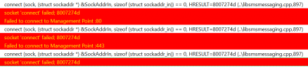

There is a screenshot of the ClientLocation.log :
I solved part of my problem but the apps still won't install yet.
To bypass the mentioned problem, I added the following parameters for the SCCM Client :
/UsePKICert /NoCRLCheck CCMHTTPSSTATE=31
With that, I don't have anymore the WINHTTP_CALLBACK_STATUS_FLAG_CERT_REV_FAILED error and the client is reported as Intranet. I also can see on the logs that the client is able to find the MP.
I continue to look for the problem of the apps installation step and will report it there if there is something new.
