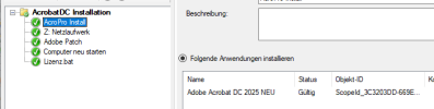

Hey, I've tried the guide and many many other guides.
Nothing is currently working.
In my workspace I need to install AcroPro.
Steps normally:
- Install AcroPro
- Connect to folder (Admin perms + Z:\)
- Use cmd to install the update
- License AcroPro with license tool
Somehow it won't work currently. How would you install AcroPro in good ways, I think my current is very bad.
(0x4005) Error also applied.
Yesterday task worked, now it's shi*...
I
Fehler bei der Installation der Anwendung "Adobe Acrobat DC 2025 NEU" (ScopeId_3C3203DD-669E-4D97-AB84-4993CA830754/Application_09e955cf-a3fe-4942-b930-84c8290e43af) für Aktion "AcroPro Install" in der Gruppe "" mit Exitcode "16389" durch die Tasksequenz. Vom Betriebssystem wurde Fehler 2147500037 gemeldet: Unbekannter Fehler
Error installing the application "Adobe Acrobat DC 2025 NEW" (ScopeId_3C3203DD-669E-4D97-AB84-4993CA830754/Application_09e955cf-a3fe-4942-b930-84c8290e43af) for action "AcroPro Install" in the group "" with exit code "16389" by the task sequence. Error 2147500037 reported by the operating system: Unknown error
error 16389 0x4005 f.e.
lizens.bat =
@echo off
"\\SERVER\sccm2016$\AdobeDC_Neu\adobe-licensing-toolkit.exe" --precondition --install --filePath ”\\SERVER\sccm2016$\AdobeDC_Neu\ngl-preconditioning-data.json"

Sorry, this was the old batch.
The new batch is only with Z: 'cus I'm connection before with Networkfolder
Running setup from the network defeat the purpose of ConfigMgr. this is not very network friendly doing it this way. But if this now work for you...
